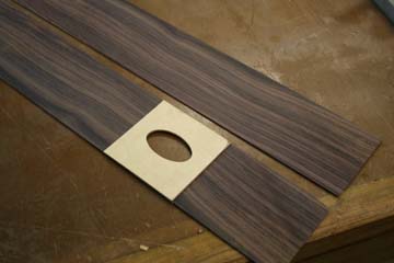

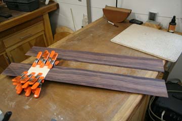

Here's my method:
First, I glue on a cross grained patch of spruce. You can use anything but I like the interiors of my guitars to be light in color so all of my braces and linings are light.

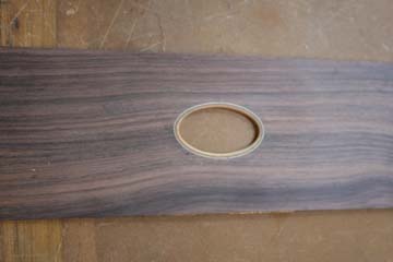

From that point I cut the hole. I just use a simple template with a pattern bit (spiral to prevent chipout)
Now these next steps are not necessary but it's something I do. At this point I bind the soundhole. I wish it was half as easy as it looks. It's very tricky to get the ends to work out the way they should.

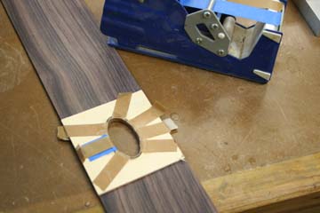

And the bound soundhole:
From this point I go to the bender. I have a little plug that goes into the soundhole to help prevent the binding from pulling away during the bend. Other than that, it's a traditional bend.
